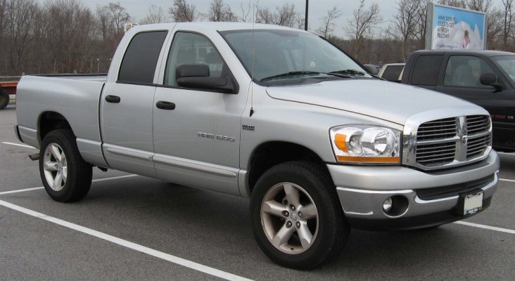

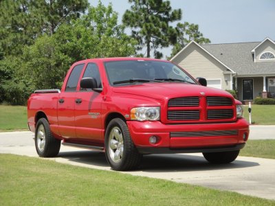

Well here's the thing, which is why I asked for a pic. On the sports bumper (body color) 02-05 it's actually part of the bumper cover. This is how mine is and it's how the chin spoiler attaches for the hemi sports and Rumble Bees:
The chrome 02-05 bumper has a separate piece:
Now the 06-08 (09 2500/3500), the chrome bumper is the same way:
The 06-08 (09 2500/3500) sports bumper I'm not sure about. Haven't been able to find a definitive picture that says either way. What I'm trying to figure out is if you're looking for the add on black piece or the chin spoiler. so taking a pic would help us help you alot lol.

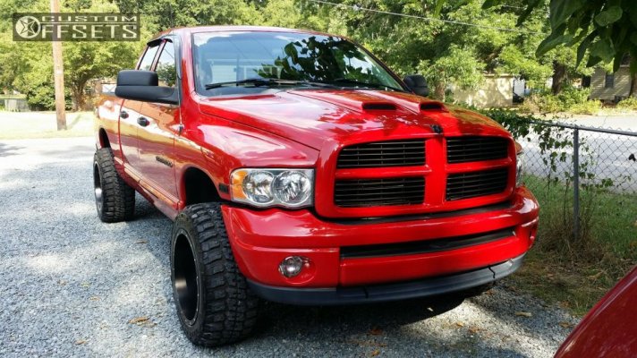

No, the chin spoiler attaches to it, there's actually the black piece (sometimes you see them body color). Mine originally looked like that red sport bumper, I just attached the chin spoiler to it the same way Bees & Daytona's do
HemiLonestar
Navy Badge Coast Guard
Jun 1, 2012
6,770
4,620
MD
So that chin spoiler like you have aka Daytona/rumble bee,are they like the regular sports where that bottom valence is molded to the cover?
This was mine prior to the install:
