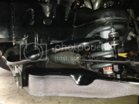

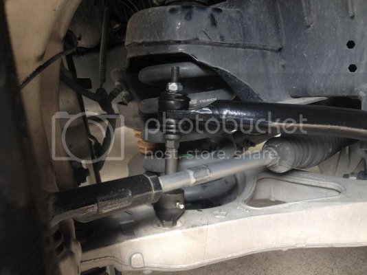

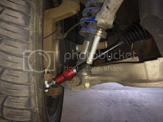

Saw this thread over on the Z forum and thought I'd share the info here. This mod will get your front sway bar more parallel with the road, which seems to improve steering response and ride. I installed the shorter end links today on my lowered '14 R/T and have to say it's a gerat mod. The end links are for a 2wd Ford F-150. I ordered Moog K80337 end links from Amazon for $30 a side. The only thing I did diffrent from the others was use both the factory and Moog supplied bushing cups because the Ford end link has a longer non threaded shaft that doesn't allow the rubber bushing to get enough preload. You can see what I did in the last picture. I "barrowed" a couple of pictures from the original thread :naughty:
