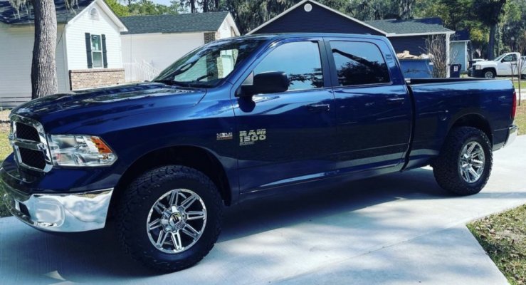

So I apologize up front if I missed the post but I have searched and searched and can’t find anything.
I have a 2020 Ram 1500 Classic Crew Cab with the 6’4” bed, which means I have the 2 piece driveshaft.
When I started looking lift kits I noticed that a lot of them said it would not work with the 2 piece driveshaft. Since then I have changed my direction and have decided to go lower.
I’m looking for 2 in the front and a 2 or 3 in the rear but none of them mention the 2 piece driveshaft which could mean it doesn’t matter or could mean they never checked because they didn’t think it would be in high demand.
Does anybody know for sure what I can do without having driveline issues? Or which kit addresses this issue?
Thank you for any advice in advance.
