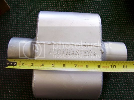

I have a Flowmaster single chamber race muffler. It's pretty loud, but at idle it's fairly quiet. I used to have it directly behindthe cab with tips but it was TOO loud; it would rattle everythin inside lol, so I moved it back towards the axle and dumped it and now it has a good rumble when I'm givin it gas but at idle it's fairly quiet. But it'd be funny to have it a little quieter and when someone is revvin at me or whatever open the cutouts and be ultra loud hahahaha
This is what I have on there, looks just like this
