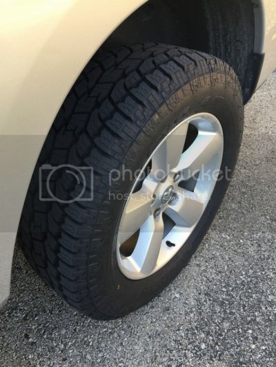

I just got new tires on my 14 v6 regular cab. I went with the Toyo Open Country AT2 in p-rated. They can handle anything I may throw at them, and they are lighter. The LT counterpart was like 70lb a piece. I dont need all that extra weight, now would I ever be using the actual full potential of a tire that beefy. I also did not want to be running a full 12.5" tire, while it looks cool, I think it could be of some strain. And these are rated at 2600lbs a tire, I think that is more then enough.
