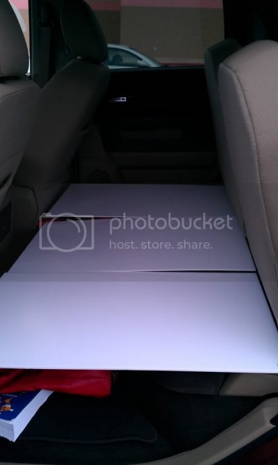

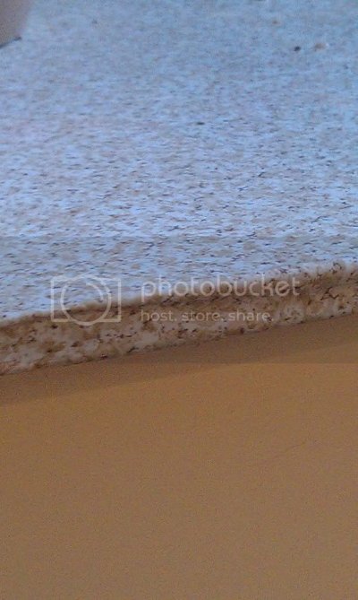

Not exactly sure if this is the right section since I haven't made it yet. But thinking about making a fold flat floor for my truck from wood that would sit on top of the underseat storage bin lids and would go from the back of the underseat storage bins to the back of the front seat(about 28") and the width of the storage bins(about 58") and would have legs of some sort under it where it meets the front seat for stability(about 7" tall). Would cover it in carpet like for sub boxes or this contact paper stuff in a roll that I have on wood already for another use(I'll post a pic of it in a little). This would be for occasional use like carrying boxes and other stuff that requires a flat floor.
My question is what would be the best wood to use? I'm guessing plywood?
Which covering would you use to cover it? One of my 2 or something else?
Would you make it fold or make it one solid piece? If folding, what kind of hinges?
And how should I properly transport a big sheet of plywood from like home depot to my house(about 8 miles) since I have a 5'7 bed? Bring one of my saws and cut it in half at the store?
This is my first time building something like this so that's why I have so many questions

Picked up some foam board to show my design. It's 30" deep and 60" wide. To get it out you just tilt it and pull it out which would be the same for the non folding plywood. Except it would be one big sheet of plywood and not 3 pieces lol

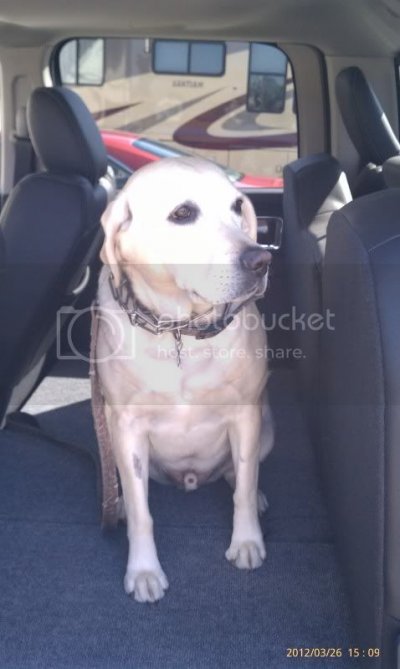

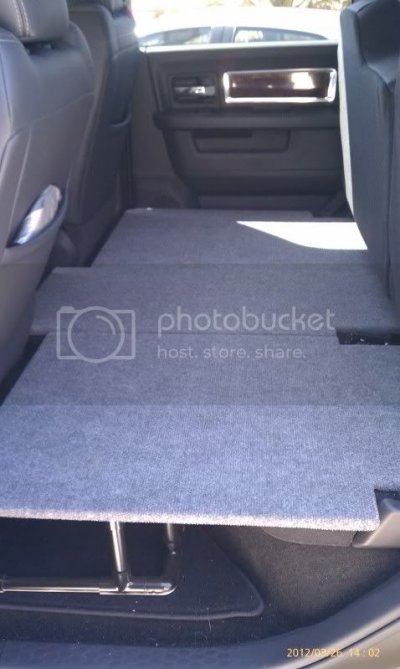

This is one that a buddy of mine and I made recently. Looking to have a way to haul my Lab around. We designed it to be lightweight and easily removable. The supports are PVC and the platform is plywood. I wanted to have the option of using the smaller rear seat for someone sitting in the back seat. Covered it with grey carpet from Home Depot.
The Lab checks in at around 90 pounds and the platform kit is solid.
Looks really good! I wasn't gonna cut around the hinges and all that but now I think I will. What did you use to make those cuts? And did you make a cover for the hinges? Pics without the dog have the hinges showing but the pic with your dog has them covered(between the closest panel and the middle panel)

A skill saw was used to make the cuts. Nothing fancy...
The piece over the hinges is left over carpet. Figured I would have it there to keep his paw from coming into contact with the hinge.
If you don't cut around the hinges, the material that you use probably won't sit totally flat.

Finally made more progress. Time to tape it together and make sure the fit is correct as a one piece unit and then get some plywood and transfer the design. Then make some legs to support the front and get something to cover it
