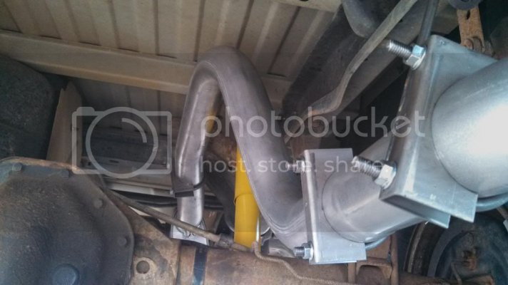

And now for some pics.
This is the rusted out crap I replaced.
This is the piece that was touching the transmission pan.
IMG_20131201_114320_631_zps6ecafb7c.jpg[/URL
Don't mind my bumper, it is getting replaced as soon as I can find one.
It seems like a lot of clamps but it's not, half of them are a clamp on style exhaust hanger.

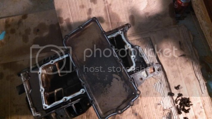

Just got done wrapping everything up. I had a lot of other stuff going on so the project got spread out over a couple days. What a huge difference in performance! Replacing the distributor cap/rotor/plug wires/plugs and having a nice clean throttle body and no more plenum leak makes this thing feel like a totally different truck.
Here is a pic of the plenum plate.
The distributor cap and rotor were toast. Combined with the condition of the plugs, I'm surprised the truck ran at all.

she was in dire need of a tune up - was the plenum pan gasket completely blown? I see one bulge curious if it was blown out or not

It wasn't completely blown, just that one spot you see in the picture. You can tell what the effects of just that one bulge in the gasket are by looking at the black sludge at the bottom of the plenum. The sludge starts out the same width as the bulge and then spreads out toward the other side. It's no wonder they fail, that gasket material was total crap. I used a Felpro replacement gasket and it was really nice quality and had a metal core. I also put a light film of ATV on both sides of the gasket.
