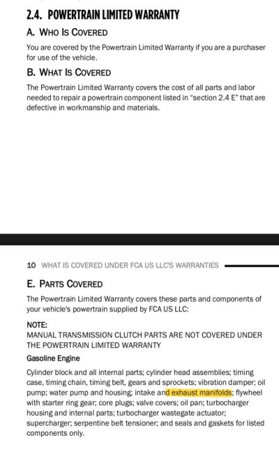

From the same 2021 Ram 1500 warranty booklet I posted above (that booklet really does make it clear so people don’t have to just guess):
Jimmy07
Feb 23, 2017
3,512
3,565
FCA is somewhat contradictory with statements expressed. See the underlined fine print below. :cool:
Not contradictory. Federal law requires those parts for 2/24,000.
They’re just saying that all of those parts are covered under their own 3/36,000 basic warranty anyway, regardless of the federal law requirement.

2013 ram warranty booklet:
