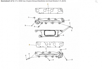

Don't think there is 1.....the photo looks like its not aligned correctly.....maybe cleanup & tighten bolts.

Looks like the nut is missing for the bolt on the backside........side with nut showing is pulled up more....could have bolt cocked & in a bind the reason it did not fall out......someone work on exhaust recently

Yea the bolt and nut are gone, its cocked on the joint, clean up the ball and socket,replace them both and be done.

I'm assuming the bolt and nut are there just the picture angle, but for sure there is a bolt there.
Looks like it could be cleaned up and centered a bit better and tightened up.
