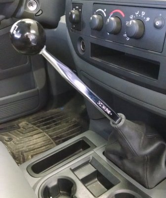

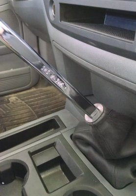

I reused the factory shift boot with the new Hurst stick, but didn’t like the way it looked. I purchased a Hurst shift boot grommet from Core for $14 that fits over the stick and has a groove for the shift boot to set in. The factory boot is made from rubber so I used a plastic bicycle tire tool with a hook to pull and stretch the boot over the grommet. The shifter now looks more finished and the boot doesn’t slide up the stick.
The Hurst stick is used with several different kits, so its design isn’t exactly the same as stock. The knob height is the same, however its position to the driver is not. The angle of the stick is not as steep as the factory setup, so the shift pattern is farther away from the driver. It’s not uncomfortable to shift, my arm is more out stretched than before. The shifter base pivot is shorter, which makes each shift noticeably shorter. I’m planning a few performance upgrades to my truck in the near future and wanted a short shifter to give it a sport truck feel. The SRT Ram comes with a Hurst shifter and I was curious if a similar upgrade was available for the other Rams - a simple Google search brought me to Core Shifters.
Overall, I’m very pleased with the Hurst shifter. The internal mechanism of the factory shifter base is built with a lot plastic to reduce noise and vibration, but it caused the shifts to feel very spongy and loose. The Core Shifter base is all metal construction and each shift is definitely more solid and precise. Shorter throws, firm shifts and classic styling of the Hurst stick and knob are the reasons why I’m very happy with this purchase and recommend it to everyone with the manual.

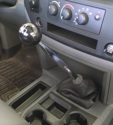

This is how the shifter looked after I first installed it:
Here's the final install:
