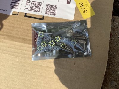

I did mine this weekend. I popped the white plastic out then popped the black trim ring off around them. They were 194 halogens got these from amazon. 10 for like 12$ They have them at autozone but 14$ for 2
