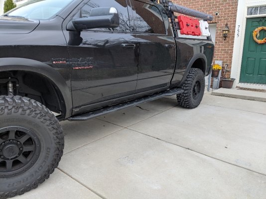

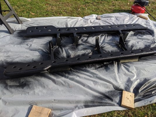

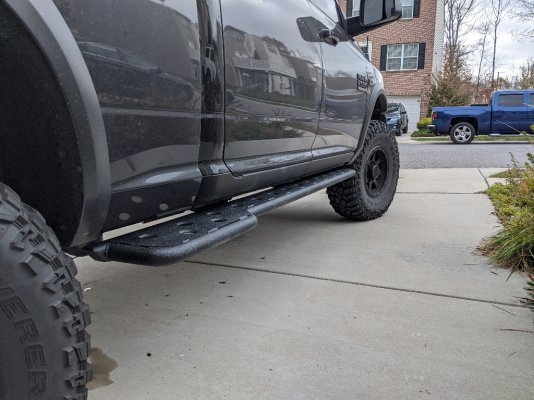

So after weeks of mulling over white knuckle or Maple Offroad I finally pulled the trigger on the Maples. First and foremost Neil at Maple was absolutely amazing with his customer service. I will definitely be buying more from Maple. I had a tight timeline to get these installed before my camping trip this Wednesday so after talking to Neil via email he assured me he could get them to me and he nailed it. Plus side to me ordering Maple in the beginning was price, 1)cheaper by about $50 total after shipping, 2) timeline, 3) shipping service was UPS which had a frieght location 20 min from my house.

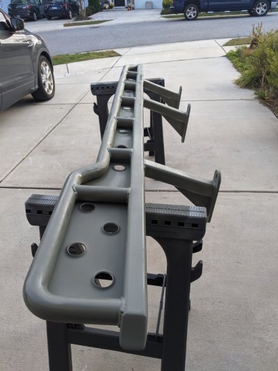

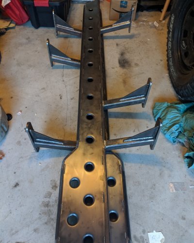

I went with the full top plate on mine with no coating as I was gonna raptor line them. Last Thursday I picked them up from UPS.
I sanded, with 80 grit, thoroughly cleaned and laid acid etch primer first. Let that cure for a day. Then I wiped down again and laid down the raptor liner. I bought their kit that includes the gun. This stuff sprayed surprisingly well, I used a 6 gallon Craftsman pancake compressor. Laid two coats of raptor then let the wait begin for it to cure.

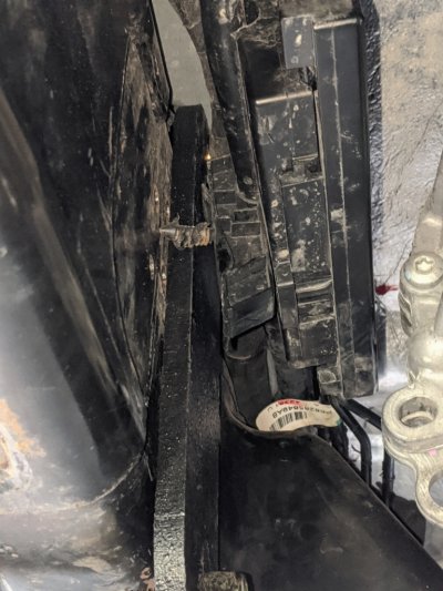

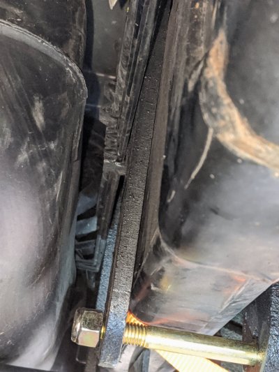

Week later I got to installing. Very straight forward. Driver's side was a bit of a *****. First on odd years like mine (2017) Neil warned me of a bundle of brake lines and wiring harness that runs along the frame. First you must take off a plastic bracket that houses the brake lines and pull it away from the frame this is near the front bracket closest to the fender. I used a piece furring strip to wedge behind it to give me room to work. I ended up doing this all myself having a buddy would help alot. I found center of the slider and laid it on my Jack and carefully lifted into place. After getting it close I put ratchet straps around it to help secure it in case it flipped off my Jack. The rear two brackets were very tight to get to. Having skinny arms would've helped getting to the top bolt on the bracket near the fuel tank. The brake line bundle must be pulled away from the frame from these areas as well to slide the backing plate behind them. I snugged the middle bracket and made sure the slider was in position I wanted and snugged the other two brackets. Then I went back and torqued evenly to 80ftlbs. This side took me about 2 hours that included taking off my old steps.
Passenger side was a breeze took maybe 25-30 min tops. Only real interference was a unused grounding stud that needs to be cut off. After that's cut off it's clear sailing. Removing the floor cubby would make getting to one of the bracket bolts a little easier but I was to far in and just struggled around it...lol All in all thoroughly impressed with these. Definitely able to jack the truck up with these. Install was maybe a 5-6 on toughness scale for someone with decent mechanical skills. I work in power plants so I'm used to working in crappy spots.
There is about a 1/2"-3/4" gap in between them and the body. I couldn't get my fingers in but I also have bushwacker rocker panel protection on there.
I opted for the standard size width on the rub rail. I will say of you want a true step the standard width won't be for you. I would definitely talk to Neil about widening that area. You can step on it but there isn't alot there. I will try and get measurements later today. One thing I may do is find some rubber and put it in between the brake lines and the backing plates.
All in all this probably is my most well built stout thing I've bought for my truck. These are worth every penny. Fit, fabrication, and customer service was all stellar. Love these sliders, Maple Wagon FTW!!5754259908530a931769af55532dde8c.jpg5fb1c73b9c9038c57dd540f9534907d2.jpg3489ab41598ba0657b66bdc28bde5fd1.jpg7ac08a5a62a8ae931309a5937be7248e.jpg9bcb1ca3a842633fc615a82c43d02595.jpg3cdf8772b45b9b11b13834a56495c943.jpgfd0735764ab0f60923726eedd61e3a50.jpg6a1646c7341220902b2282a396f4fc85.jpg844a2f245a4ede936e66d69ca34743d9.jpgcb920de861f7307d79a48142cd7de40e.jpgb662f32122302c317ff2bf0f57308583.jpgcc196299426551091a7d0a0e31fd2cde.jpga605b078acb6c24f113c9b077c72ba16.jpg

Are the WKO sliders wider in the "step" area? These are definetly too narrow for my taste. I like them but I would need wider for trixie
Sent from my SM-G960U1 using Tapatalk
Maligator
Maligator
Jun 30, 2017
1,162
1,643
Hem 5.7

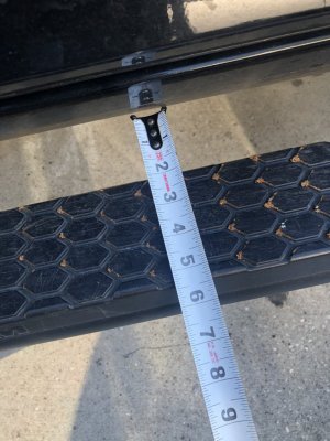

Reading the thread I posted below looks like WK is standard with a 3" wide area. I will measure mine when I get home. I'm sure Neil at Maple would accomadate a request for a wider rub rail. I know one member here has WK that he custom ordered with a wider step.

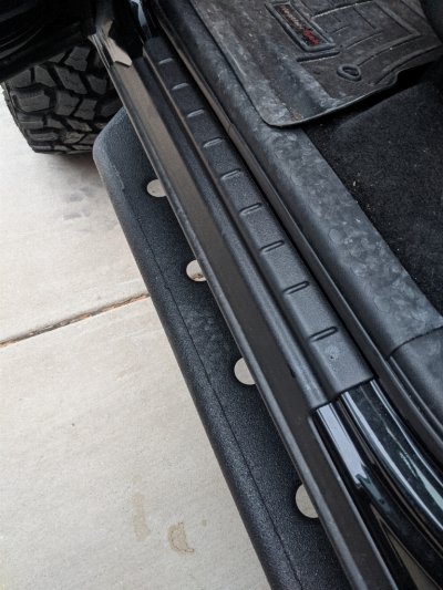

Here's some pics of the step area. Also you have a little play to drop them down which could allow you to get a little more footing. The full width is 6.5" but most of it get tucked under the rocker panelc10fb35bd7df656aa818de8bf416e34c.jpgef0ee122e5a8900628b8326f83d32fc5.jpg

Thanks mailgator for the pics. As high up as my truck is I definetly will need the "step" area wider. Probably 8-10" out from rockers. I definetly like the skin coating and will be doing that when I can afford to buy either these or WKO. I am still unsure about the top plate just because of the amount if mud that will collect when going mudding. I think the open design will fit me better since I dont want to spend 20 minutes pressure washing the underside lol. It already takes me 1 hour to wash the truck cause I have to use a tough box to reach the windshield and I have to hop (literally jump up) into the bed and get the roof. Thank god for the foam cannon.

That picture is a little decieving the total width of the area is tucked under the rockers quite a bit. from the pic looking down on top of them you can see how narrow the foot area is. You lose quite a bit with what your rocker panels cover. Also your factory steps also drop down a bit from the rockers giving you more foot area

Snapped this one leaving work today, doesn't bother me but I know my wife is going to hate it...lolfc82f6e0dbbde36e352d61a85906a3d9.jpg
Trailmaker
Locked and Loaded
Jul 28, 2019
1,814
1,687
Conroe Texas
2021 PW
Yeah not much there to step on. Looks doable get in to the truck but useless as a step to get out.
My wife is 5’4 so I would need 2-3 more inches for her not to hate my $1200 purchase.
(“That’s what she said” yeah yeah)
Like you said, I’m sure Maple can accommodate this request. maybe make the flare out at the rear tire the same width throughout.
