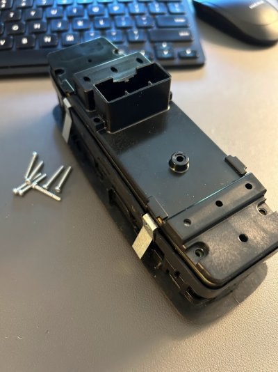

I took off the window switch and decided to see if there was something I could fix instead of buying whole new master switch. I got these screwed out with the T10 torx bit.

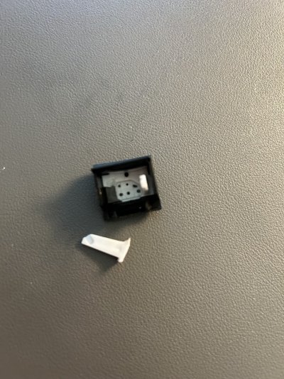

The cover came off on the bottom side and this is what it looks like.
I turned over the assembly and immediately these white part fell out. They seem to push the buttons back into place but I am unsure on how they were oriented inside.
So I figured out where the white piece go. They are for the mirror adjustments on the front/top as shown.
And here is the problem child. I think some JBweld or superglue should fix this.

Got some JBweld and put it back together. Hoping I can save some $$ and not buy a knock or mopar unit.
