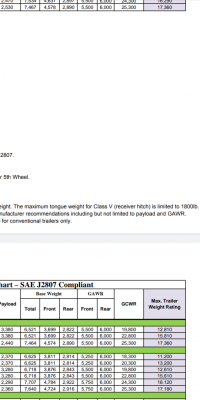

Max tongue weight is 1800. I didn't notice a chamge for 2020...but you said 2000.
Anything over 1800 should be a 5th wheel or gooseneck.
Very, very few trailers have a 10% TW. The maximum allowed bumper pull is 18000.
Alot of people seem to miss that the max tow HeavyDuty is a gooseneck setup. Even the 5th wheel max tow comes out less than the gooseneck.
Hopefully you can do something with the location of weight and get that TW down below 2 grand (closer to 1800)

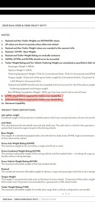

The FCA J2807 chart I looked at, mentioned a 5th wheel hitch is required over 23,000lb, and a gooseneck is required for over 30,000lb. So it seems your combination should work, but I would look at a upgrading to a receiver hitch that is rated to your tongue weight.
You should still be under the GAWR, and within payload and GVWR and towing capacity. Just need that correctly rated hitch.
