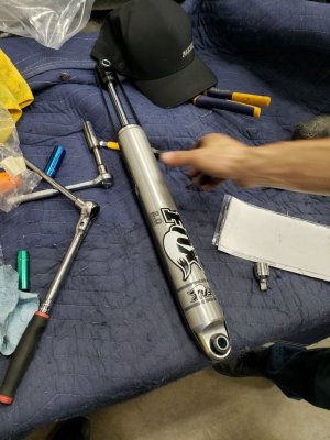

i would recommend going with the rear Fox shocks that Maxtrac would offer with their Fox kit and then Fox replacement front shocks. This will offer a much smoother ride on and off road. There are cheaper options and there are more expensive options but this will be a good bang for the buck setup. It will be good enough for minor off roading and ride nice on the street while not breaking the bank.
I'll get some pricing over to you tomorrow. I have pricing for the fronts but just need to verify the part number for the rears with Maxtrac tomorrow and then I can get you pricing on them too.

Agreed, the fronts aren't much more than quality replacements. I believe the rears are going to be about the same. Just a little more than standard replacements. It is worth the little extra for the much better ride comfort and performance.
