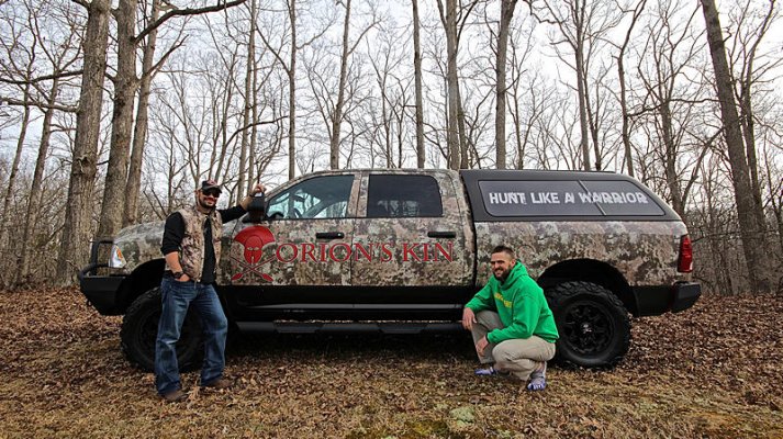

Factory side steps are long gone for many of the reasons here. I traded in the truck below because the MPG was killing me. Thats where the "no lift" mindset comes from. I put 40,000 on it in the first year and averaged 12mpg on the highway. At the price of diesel, it was just too much.

Is this truck a 1500 or 2500?
When you said crew cab long bed I assumed an 8ft bed only available on 2500
Should have deleted the other truck.
