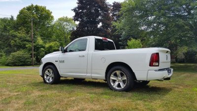

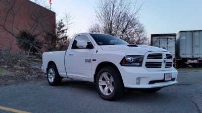

I bought my kit from @Nick@GotExhaust.
I have a 2016 rcsb, but I am 4X4 and I have no issues with it at all and it is a true 2" rear drop. Rides great as well.
Let me know if you would like to see photos.
*****EDIT!!!!
I have the Ground Force kit.
