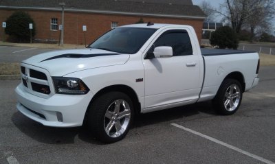

Finally got the McG Deluxe 2/4 kit installed this weekend. Also go the Spohn adjustable panhard and AirLift 1000's put in as well.
Sure handles and rides different, I can tell the center of gravity is lower, and feels more responsive. So far I'm very pleased. :rockit:
.Here's some before and after pics.

Looks really good! Were did you get your hood graphics?

So far I've had it up to 95mph with no wobble issues. It actually feels more stable than before, probably due to less air going under the truck.
So far I am very pleased with the kit. No issues at all.
I got exactly 2" drop in the front, and about 3" in the back, but that could be due to the AirLift bags I have inside the rear springs.
The only negative I would have is how the new spindles move the front tires out about 1/2" from stock, but it's really not that noticeable unless you really look for it.
