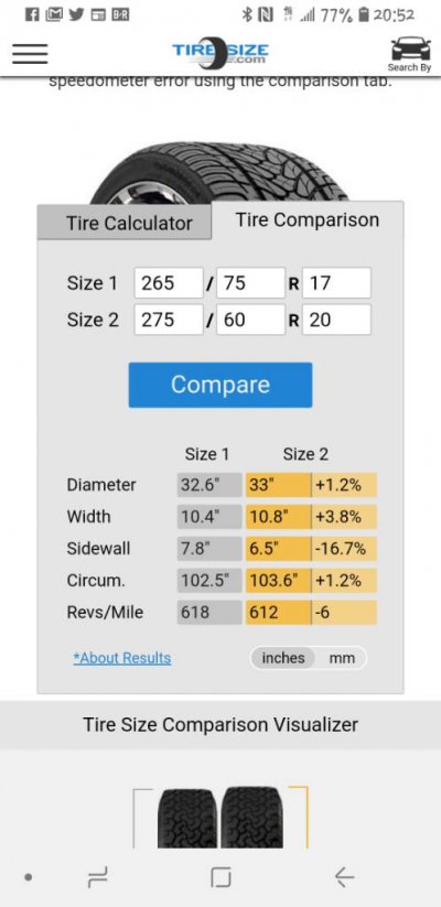

hehateme2812
Aug 31, 2018
38
15
New York
More info to prove you changed tire size throwing off your truck and mileagefa3c5a98ed9b778abf17cc100c7944cd.jpge1b2c1a2dabf44a04fa860dc312b9044.jpg
