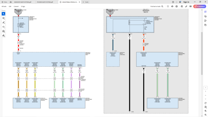

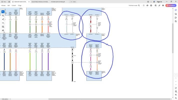

I have a 2015 Big Horn, with cloth heated seats, chrome mirrors, and I have actuated the tilt in reverse and passenger dimming mirror options on it with alpha obd no issues.I have now added heated/vented memory seats from a Laramie, so far activated the venting, but I haven't hooked up memory functions as I do not know which extra 4 wires to add in which pin outs from seat plug to door/dash for memory function. Would also like memory power pedals if anyone can help with that wiring too!

Unless you have the memory dash harness, I doubt you will be able to get it to work. I installed a 2016 dash harness, and while it does have the adjustable pedal connector, there is no memory wires in it. The 4 pin connector is there, but with only 2 pins. I checked the wire diagrams as well, and you'd have to repin the C2 connector under the seat, and run the pins all the way to the power pedal connector, plus change the power inputs.Screenshot (179).png
