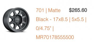

Happy New Year gents!
I have a 2015 RAM sport that came with the stock 20" wheels. I am looking to swap them out for Method 701 17"x8.5 | 5x5.5 | 0/4.75" offsett. Will they fit without issues? I obviously will require bigger tires to have the same ride height i have now. I am not a wheel expert so hoping someone here can school me.
Thought? Advice?

They should fit without any issues. I'm running 17x9 Raceline Clutch with a -12 offset which is 4.5" backspace with 315/70/17. was running them with a little 2" level front and stock rear initially.
These are method 17x8.5 0 offset on 35x12.5x17
https://www.customwheeloffset.com/w...2014-ram-1500-method-nv-bilstein-leveling-kit
You can check that website for more setups in 17" wheels.
