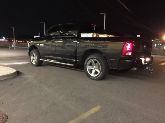

Easy install minus the top nut. It was a *****.
zstampe
zstampe
Jul 16, 2015
516
399
That looks GREAT !
Thanks man! The ride, holy ****, it's sooooo much better than the spacers. If I'm ever in TN I'll buy ya a beer. You indirectly talked me into them with all your posts about how great they are etc. Ha ha
