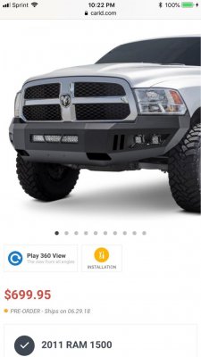

I have never thought aftermarket bumpers looked good on rams, until i saw this one. Of course, if i build it, it will be different. But this seems like a good platform to build from. What do you guys think? I just dont think tubes look good on front bumpers.

This is my personal favorite as like you said, it isn’t tubular, but I love how minimal it is for more clearance. But yes, I think you could definitely build one easy enough, however maybe look into “move bumpers” they sell a DIY weld kit that’s oretty cheap for the set up

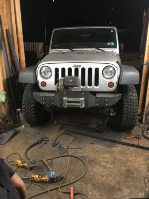

I can build the bumper out of 3/16 mild steel plate for $150. However it would be easier to use a pre cut bumper kit, i enjoy cutting my own pieces, and fabbing my own. Here is a Jeep JK bumper i helped my buddy build. Its just tacked in this pic, not welded out yet.

I can weld but I don’t think I could fab it myself from scrap. That’s awesome!
As long as ya got a 6” grinder and some wafer wheels, you can cut 3/4 the way thru, and make your bends, then weld them. Just have to make nice cuts and have some angle finders to match angles. Its not bad.

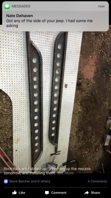

I really like this bumper i posted, but would like to change a few angles. Im the kinda guy that likes to see a photo, then be able to make changes that i like.
Poison spyder makes “$800 rock sliders for jeeps, so i made a set similar to them, but changed a few things. Both of these pictures are the ones I made. Rough, and finished.
