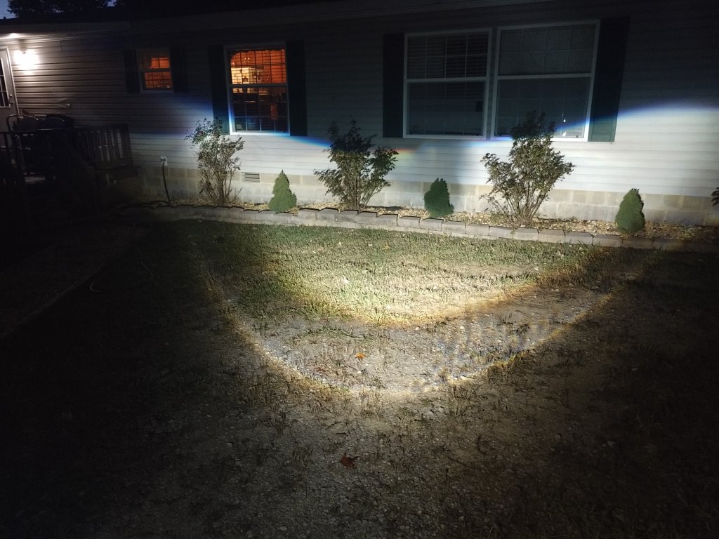

I just installed a set of the modifystreet branded headlights, the single projector oem style that would come stock in a 18 sport/laramie. Xenon depot HID's installed. All the lights are working perfectly, except the cutoff shield on the passenger side is drunk.
Passenger side
full
Driver side
full
there an easy way to fix the passenger side shield, or do i need to just send these back for an exchange?

One thing that kicked my ass on the 2019 style ones was the placement of the bulb.
Gotta be very particular in placing it.

So I should reseat the bulb?
What do you watch for when aligning? It's a h7, it clipped in. The way it installed in the bulb holder put the outside wire at 6 o clock.
I will pull it out tomorrow and check it. Hope it's an easy fix.

I couldn’t actually find an exact direction to point the outside wire on my HIDs to be honest. There was no definite direction that I could find to be absolutely sure it was correct. Someone else hopefully will chime in if there is a definite direction to put them.

I had the headlight powered and carefully kept unseating and reseating bulbs until I got the perfect position.
Now I have sharp cutoff, level, and the high beams don't look crosseyed (which they did on the driver side) due to slight placement issues.

Ok, I will definitely do that tomorrow. I didn't realize it was that finicky.

I took the bulb out today and put it back making sure it was sitting perfect in the mount, the cutoff is perfect now..thanks everyone.
