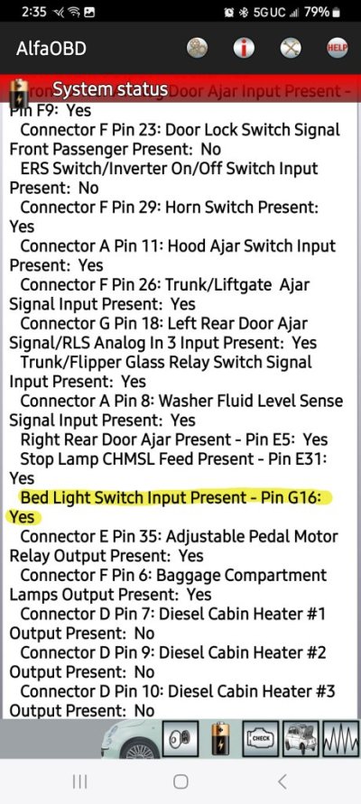

HI, I have a 2019 Ram 1500 and also install the Mopar Bed Lights. I was able to enable the pin G16 to yes and pin A5 to yes but I couldn't the "F connector F pin " Baggage compartment lamps Output Preset } Yes. My bed lights aren't turning on.
Any help would be greatly appreciated.
I realize the F pin is set to Yes
