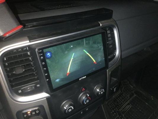

let me start from beginning. First of all I installed backup cam with wiring just after purchasing a car (not Mikes fault)

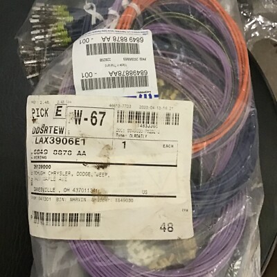

They replaced all wiring from fuse box to female with female socket also ( was so sure that parking light is involved with faulty bcm) ugh… I’m just a plumber

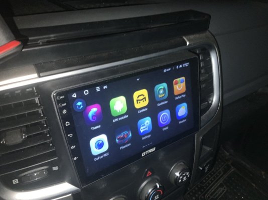

Original tailgate backup camera with wiring from Mike and custom radio with apps on android software. Mine truck comes with just a handle without camera. Hate that buggy radios from fiat….

Will send some pics later, needs to check if mine dealer replace that wiring…. Never trust dealers

To be honest it’s up to u. I prefer original cam that is hooked up to radio and that radio has tons of improvements. Sorry didn’t check anything today but will do pics
