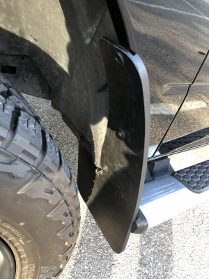

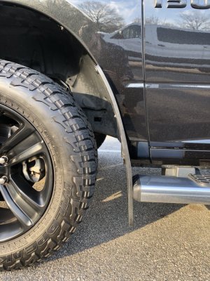

Got them on. I have wheel to wheel steps, so molded flaps were a no go. I’m actually digging these more than molded now that I see them on. They give off that old school vibe. I removed the plastic corners for a cleaner install.

Yes and no, the front and rear utilize the bottom two screw holes which hold your plastic corners, if you have them. In the front wells you have to drill a hole for the inner most nut & bolt through the liner along the bottom. My fenders did not have a screw for the highest point on the mudflaps. The hole is there but no screw. So instead of hunting down a metal tab to place on the liner to install the provided screw, I went and bought fat push pins for fenders at ACE hardware. If you zoom in on the picture you’ll see what I’m talking about.
The rears have the all the screws in the fenders, but you have to remove the wheels to drill a second screw into the liner and supporting plastic behind it along the bottom.
The front flaps come with all the extra hardware you need minus the pushpins I bought on my own. Install sounds complicated but it was not bad, as long as you have a floor jack for the rear.
