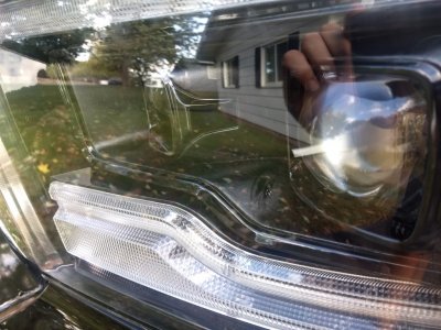

Another XB melting case.
Five months in. Adjusters are NOT broken that I can tell. Projectors do NOT shake in housing. This is present on BOTH sides outer projectors. Im also noticing a candle type flickering on the driver side side marker .

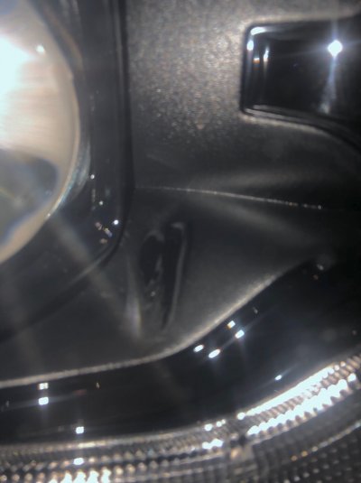

It's ********. 1400 lights and this is what you get
I know... I had to get that one replaced because of wires hanging down in front of the projector and now I noticed those markings. Aaaand my drivers side isn’t level. It flares up on the ditch side

I have it on my passenger side too. It is on the black part, looks like the paint melted

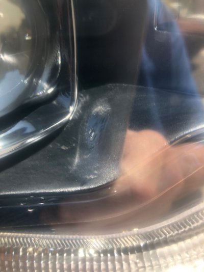

It looks like it is in the same spot on everybody who has it... that would point to heat from the projector I suspect

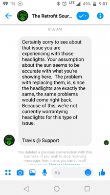

Here’s a little better photo I took. I’m not sure what the risk of fire may be, I reached out to Morimoto for their opinion

So, what is the company doing to remedy all of this? Covered by warranty?
Arcangel06
May 12, 2019
11
8
54701
What good is warranty coverage if the issue is just going to reoccure?

I’m surprised they haven’t done testing on these to find out what the problem is. I suspect it is melting from the inside due to the heat sink being too close to the Bezel, since they all seem to be melting in the same spot
The liability could be enormous if there is ever a fire, they should be doing a recall on them
