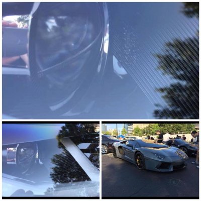

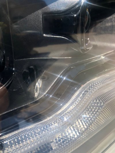

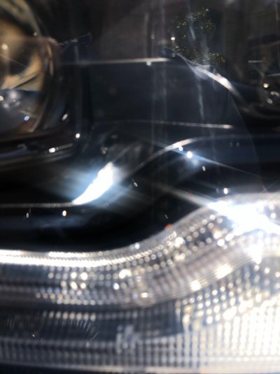

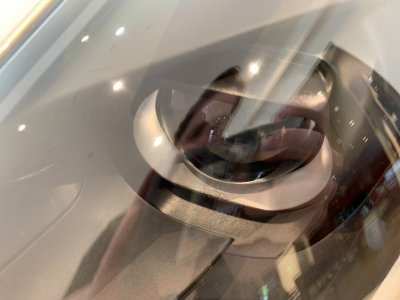

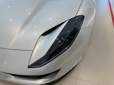

I will however point out that this is not really something that only affects these lights...it's pretty common for most any projector-based headlight. When sun comes through the top of the lens and refracts back onto some surrounding surface inside a headlight housing (like a magnifying glass onto an ant) - it happens.
I've attached a few random examples of this, ironically both on $400K+ cars on their factory headlights.
