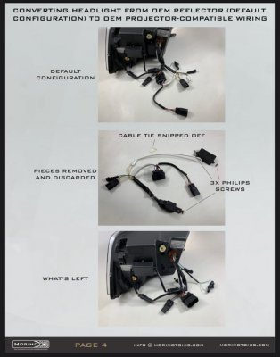

The instructions for the installation of the Morimoto headlights for trucks that have projector stock call to remove part of the wiring harness, as it is wired by default to go into a truck with reflector housings (see below).
My question is, how functional is the wiring that gets removed? If I’m not mistaken, that wiring looks suspiciously like a wiring harness that will convert a truck’s reflector wiring to a projector headlight. When I go to sell my projector headlights, can I say that I can include a harness with them that will allow them to wire right up to a truck with reflector headlight? It looks suspiciously like the harness offered by the retro shop and others, but that harness looks like it needs a 12V power source for some reason, and the Morimoto harness doesn’t. Thoughts?

Good question, I'd say "probably?"...

That’s what I’m thinking too, I just have no way to verify. I mean, the plugs are all the same, so as far as fitment goes, it *should* act as an adaptor to go from reflector to projector. My only concern is that the retro shop harness requires a power source, whereas the Morimoto doesn’t. Does the harness sold on this site require 12V power? The one sold by M2 Mods? @Mpgrimm2 and @DeereGuy , any thoughts?

I don't sell any headlight harnesses, but looking at the pictures for the Morimoto headlights ...
It looks like they build them for factory projector trucks (the 14pin projector connector carries several signals/power) and just use an add-on harness to convert them down to a quad headlamp truck system ... Which is the adapter harness they have you remove (keep it for resale later).
I wouldn't focus on differences between what they do with their custom headlight wiring and what Retroshop does... There are often different ways to get to the same outcome.

Gotcha, I could have sworn you guys made a conversion harness. Any thoughts on why the Retro Shop harness requires a 12V power source, what function that would serve? My fear is that the harness that is made by Morimoto that gets removed also needs 12V, but it grabs it from a splice in one of the plugs within the Morimoto headlight, which wouldn’t be provided when trying to use the harness as a stand-alone conversion harness, therefore not working in that manner. From a plug standpoint, it looks like a regular conversion harness, I’m just worried it won’t behave that way.

That makes sense. So his harness grabs signals from the factory wiring, probably uses some kind of resistor to keep the system from realizing no headlights are on that circuit, then powers the new lights off the battery directly through relays. The Morimotos likely just act as a plug redirect. So the answer to my question is definitely maybe.
