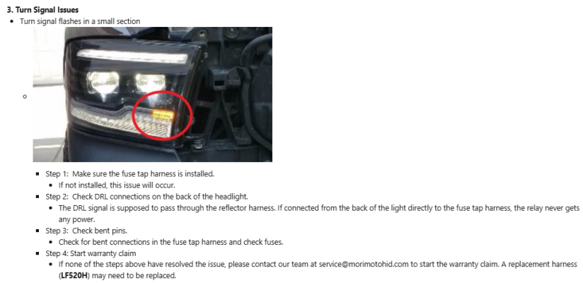

Yep, no luck. Just tried the new resistors, same issue. AlfaOBD it is!
Called again. The guy said the resistors should’ve never been sent out in the first place and that there is a continuity issue within the lighting harness. A new harness is being sent my way. Should arrive by Wednesday. I will still keep everyone updated so far they sent me this image
