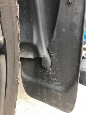

I took close-up photos of the front and rear of the truck flaps again. You can see that the rear flaps are untouched in a modification sense..simply align and drill the holes to fit them to the "Wheel Spats" bolt locations.
The front flaps are indeed notched. See the truck photo...they fit behind the inner fender and other then a "U" shape notch to fit the lower fender area are fully intact other wise.
I photo shopped the parts picture to show how they are notched. This is by no means to scale at all,..it just gives you an idea of what was done.
