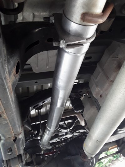

Just about to go ahead and delete the muffler to go along with my Stage 2 SFT tune. I already am fully deleted to the turbo so I figured lose a few pounds and see if I can't get a little more diesel sound out of her....

That sounds awesome! Did you purchase the piping from a website or get a local shop to do it? What is the SFT 2 Tune?

SFT is aka "Sofa King Tuned" an OBD port installed tune. Stage 2 is an "off road/race" tune that shuts off EGR as well as the DEF system and allows for the full delete of all factory emissions...... then installing a straight pipe from the turbo to factory muffler. The tune adds horsepower and torque to the little Italian V6 and turns it into a monster. For the sheer delight of adding some agressive sounds out the back end I cut out the factory muffler and added a y pipe for a no restriction staight flowing exhaust system and it sounds awesome when you step on it!
