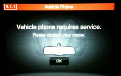

I noticed this warning 5-6 weeks ago...
Vehicle Phone Requires service.
Please contact your dealer. Upper left corner of screen says 9-1-1
SEE photo attachment below
All of a sudden about 5-6 weeks ago, this error appeared randomly while driving for a few seconds, then would disappear without me doing anything. At the time I thought it was some sort of an update that caused it, as I had my RAM into dealer for header bolt problem a couple of weeks before that.

Now I put these two incidents together, the ERROR MSG onscreen and my delayed radio startup response together... as I now read this thread below...
https://www.ramforum.com/threads/911-phone-error-warning.27340/
Oh, and yes I did notice that the compass headings (which I only noticed when drivng due SOUTH on the interstate), would sometimes be off as far as indicated direction... then would correct themsleves for a few minutes, then go haywire (usually off by 180 degrees) again.

Hey, after more research here and calling navrepair dot com it appears there is a commom failure with these radios with or without the nav feature activated. Mine is NOT activated, but David at navrepair said that the error msg with the 9-1-1 in the upper left corner is indicitive of the GPS module failing. Complete info about this can be found at this page...
https://navrepair.com/collections/r...ducts/ra3-ra4-vp3-vp4-sierra-wireless-failure
I also noticed when driving interstates that the compass would be off by 180 degrees, intermittantly, which is also an indicator that this GPS feature is out and needs to be repaired, because a satalitte fix was unavailable.
I am going to get my radio to them ASAP, and pay the $300 plus shipping. I will report back.

Today, one week after I sent my 8.4 radio to navrepair dot com, I got it back ($299) charge plus shipping two ways. Plugged it in and the radio turns on immediately, as it always had until it broke. As I mentioned in post #4, the radio was intermittantly givng me a 9-1-1 error msg with instructions to take to dealer for service. And my compass headings were screwed up. The radio and HVAC controls on dash would take from 1 to 3 + minutes to come on after starting RAM. Then everything worked as it should except for random error msg and compass headings. I was told by navrepair tech, that even though I had not paid for the NAV service, there was still a NAV device in the 8.4 radio that was not turned on yet still gave me the compass functionality.That module was not working giving me the problems I described earlier. The module was either fixed or repaired and all is good now. I was told that if I did pay for NAV service, it would have showed me that I was in Texas somewhere.
I hope this helps someone...
