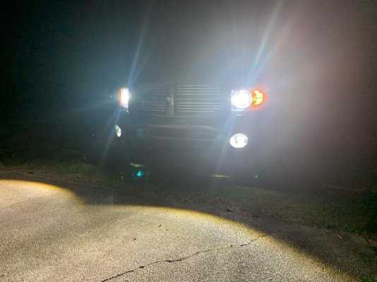

So on Black Friday 2019, I ordered all the parts for a headlight retrofit from TRS— Projectors, etched lenses, halos, HID kit, etc. i tried to get it all. I also ordered up a set of amazon OEM-style headlights to retrofit. After working with TRS a couple of times to iron out my order (10/10 customer service btw), I got the new headlights all retrofitted up pretty nice. For my first time I’m quite happy with the results

Also decided to buy some LED fog lights off of Amazon. They were worth every penny and almost stupid bright. Paired with my HIDs It looks like daytime in front of the truck lol

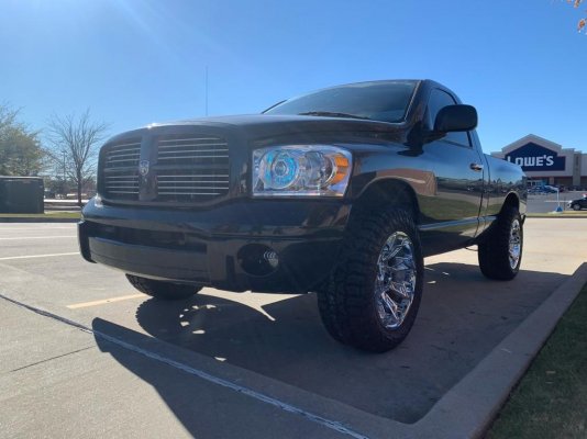

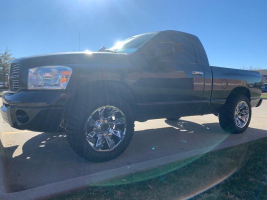

Well a few weeks ago I got the new wheels n tires put on. Compared to the old tires this thing rides a bit rougher, but the look and peace of mind makes up for the decrease in ride comfort lol
I got Gear Off-Road Slayer 20x10 -25 offset wheels wrapped in 33x12.50r20 Federal Xplora RTs. I was worried they were gonna rub, but ended up with no rubbing whatsoever
I figured going from a 17” rim to a 20” rim, combined with going from a C-rated to E-rated tire would affect ride quality (not to mention they’re RT tread tires), and I figured right. Not too bad though. These tires do give off a howl as well, but not a loud enough howl for me to hate it. I actually kinda like the noise
The V6 absolutely hates the bigger tires though. Has to upshift quite often just to maintain speed, which I knew was probably gonna happen. Every attempt to change the tire size in the computer with AlfaOBD hasn’t changed much of anything, and seeing as how no dealer in the area knows how to use their scantools on an ‘06, I’ll probably have to buy a tuner or something to change it. Speedo is about 5 mph off at 65
I’m considering going to 4.10 or 4.56 gears at some point. Hemi guys seem to enjoy 4.10s with 33s, so I’m thinking the V6 may like to step up further to 4.56s with 33s. I’d like to get some sort of LSD to help with muddy days as well
As for the tires, I like ‘em. I was worried buying tires with few reviews, but they’re pretty dang good for the price. The way I see it is if I can get half the life out of these that I could with the name brands like Toyo and Goodyear, I’d be ahead

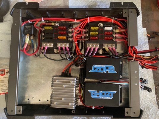

I’ve been planning on grafting a 4th gen aux switch into my 3rd gen to control all my extra electrical goodies, and its looking promising. Hoping i’ll be able to fix it up

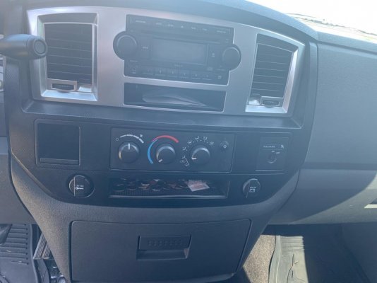

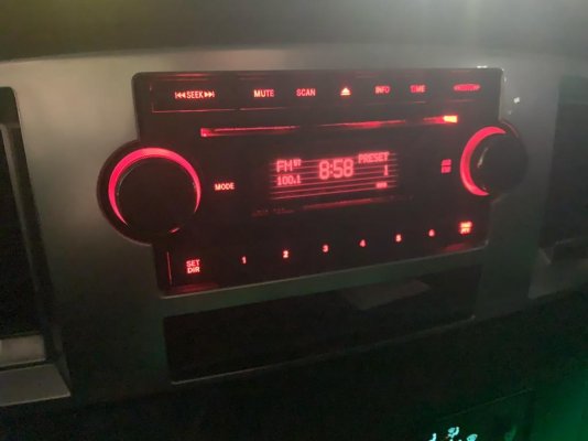

The past few weeks I took on a pretty neat project I’ve been wanting to try for awhile. I bought a junkyard RAQ radio out of a Durango, and got it all cleaned up and disassembled. I painted the face, put in a new screen, and replaced the green lights with some red LEDs. It turned into quite the project and in my opinion turned out good, especially considering it was my first soldering and circuit board project. Added bonus is the chrome premium volume/tune knobs
Heres the REF that was in before with the green colors
And heres the “finished” product. The only problem I have is the screen is very reflective and hard to see during the day because there’s zero darkening tint. I might hit it with some sort of tint to darken it down and show the numbers a tad better
I’ll have to get a less blurry nighttime photo, the glare of overhead lights was pretty bad at that time lol
I have a PAC aux adapter coming in soon and I plan on installing a little bluetooth module back there so I can get rid of my junky bluetooth FM transmitter
I think I might go red on the window switches and as well sometime soon. I have lots of leftover LEDs lol
