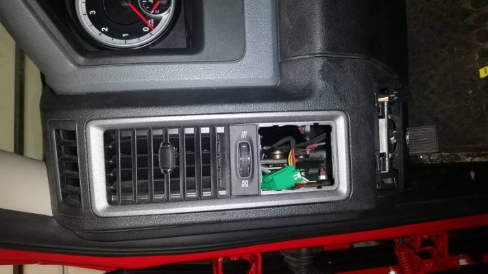

Thanks for image of radio connector with info on pins for mics. I have exhausted myself looking for which wire set 29/30 or 39/40 is for the drivers side mic in headliner of my 2017 Ram. If you have that knowledge and will share you'll save an old man much grief, I haven't gotten to the point of pulling headliner but I'm near it. Taking advantage of down time due to spine surgery to install Kenwood DNX893s, that I bought 6 months ago, and want to splice mic terminal into factory mic to avoid gaudy looking mic provided with radio, not a good place for a stick-up! Any tips members may have as I'm still waiting a couple of more days for adapters to use factory SiriusXM antenna and to plug console aux outlet into Radio or questions about install I'll gladly share. Blessings, Robert

looks like its most likely Mic1 (Left side) pins 29 (-) & 30 (+). You can also intercept the wires at the green headliner connector behind the drivers side air vent (pop of the side cover/pop out the air vent)
