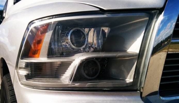

This hid projector retrofit uses 2 sets of 2.5" HID H1 retrofit projectors in a 09-17' quad headlight housing - one for high, one for low beam.
I ran an into a few snags during the retrofit process, being that it was my first one ever I had to get creative at times. I had issues with the products, fitment issues with parts and having to cut, measure and repeat was the most tedious part.

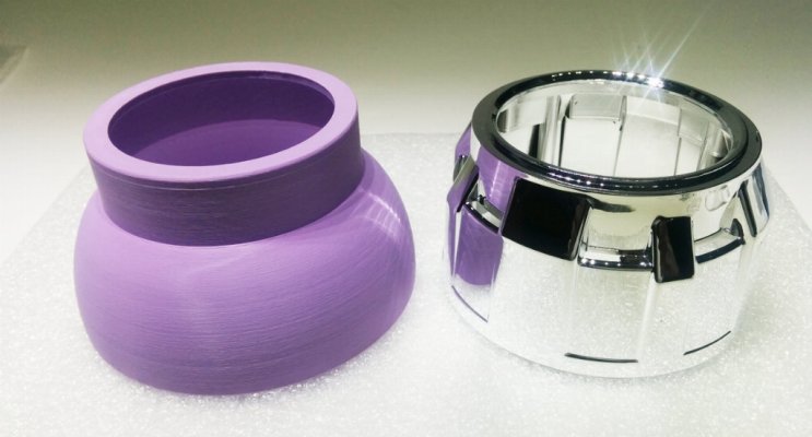

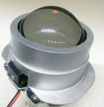

The low beam projector shrouds fit perfectly and fill up the space. The low beam projector shrouds would not fit without trimming of the oem headlight inner frame, I decided I didn't want to trim that part and designed a two piece part and then 3d printed it, in effect making my own shrouds. I didn't like the 'raw' look. The shrouds are pictured below. These parts required no screws and no glue and should hopefully last the test of time and heat.
I finished the retrofit about a week ago and drove around with them installed for a few days to be sure that nothing would fall off, or catch fire. LOL.
The headlights were purchased from a local guy who burned the mounting tabs off with his HID kit. The HID H1 Projectors are cheap amazon deals I found along with previously used/cheap 55w ballasts and 4300k bulbs (ebay specials/used). The inner housing was painted Ultra Mica Silver and a few coats of clear then baked for 8 minutes at 200 deg. The reflectors were not painted. The lenses were cleaned and cut then buffed. The wiring is straight forward and both projectors stay on and are wired to activate with factory high beams. No angel eyes or cube leds since I wanted to keep it relatively simple. There is no JB weld used at all, everything is adjustable and I can fix it easily (arbitrary).
The best part though is that I came in at a cool $99.97 for this mod, complete with all parts and pieces.

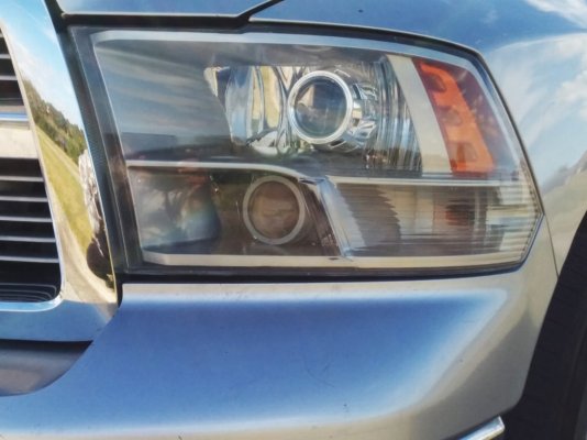

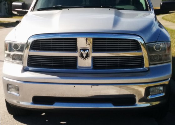

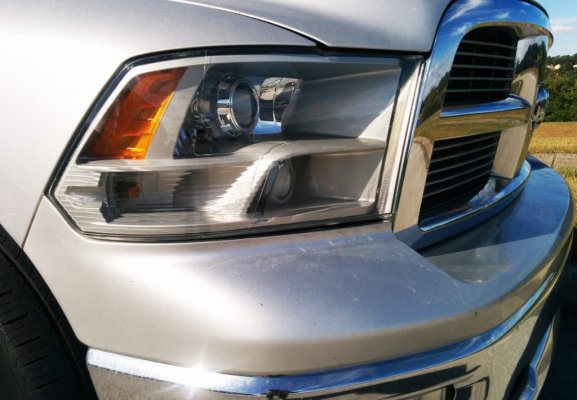

Pics after install:
Pics of the parts/process:

Pics after install:
