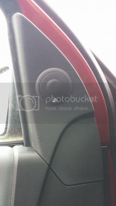

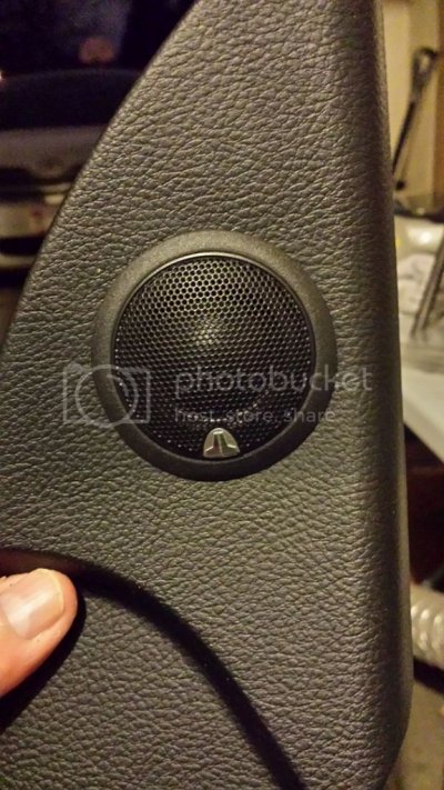

C3-600 1" silk dome tweeter in the sails

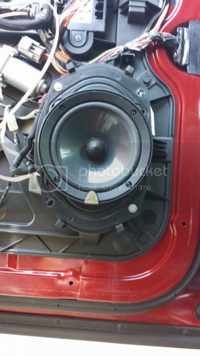

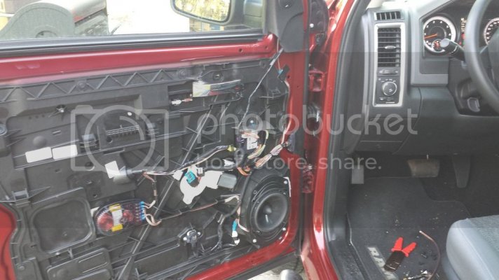

The c3-600 6" Mid with decorative ring. Door panel fits but the JL Audio Badge rubs against the door panel so I decided not to use it

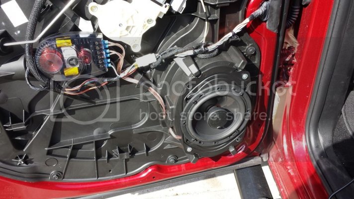

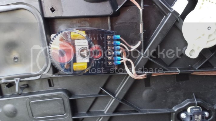

The Crossover for the front door (Driver side)
The C3-600 in coaxial mode for the rear doors
Crossover and C3-600 rear door (driver side)

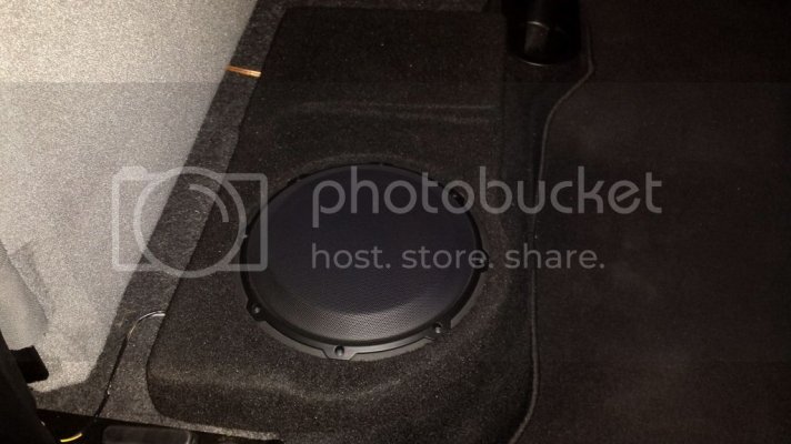

StealthBox with 10w3v3-2 Subwoofer under passenger side rear seat

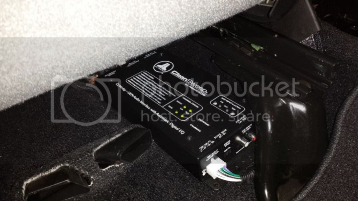

The CleanSweep under the driver side seat.

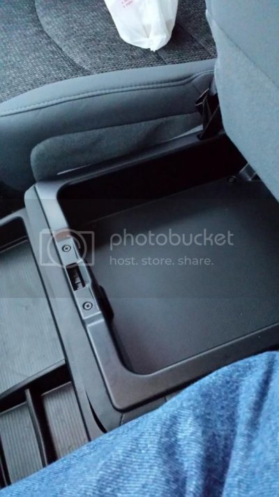

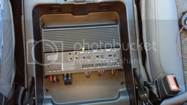

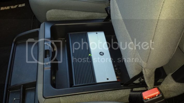

Modifying The space under the center console seat for the AMP

Thanks, I like the way it turned out myself... Sounds great too but at the upper volumes the amp is getting too much signal and the bass is getting distorted... Looks like I will need to get a DSP. I was looking at the JL Audio CL441 DSP.... I wouldn't be playing it this loud under normal conditions anyway so I am gonna drive around with it a few weeks before I make a final decision.

The clean sweep is a good option however you then need to pair it with an EQ to get any kind of sound curve since the clean sweeps only job is to produce a flat signal.
I went with the LCQ-1 from Audio Controls since it has a built in EQ. It doesn't automatically adjust the signal but the manual EQ adjustments still do the trick. Additionally, it has a feature called Accubass that seems to solve the bass drop off and distortion from the headunit. I believe that DavidRam is still trying to sell his LCQ-1. I just bought his three way components and amp so I can vouch for the quality of his stuff.
