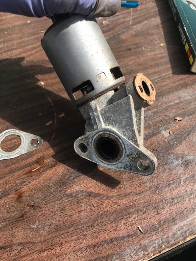

My 04 had the stalling issue like you have described and it was resolved after changing the EGR. I had already done the other items. They all work in conjunction with each other and with your truck at 36k miles, it probably has all the OEM plugs, EGR and PCV still.

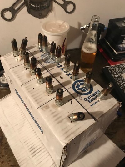

I've read that many folks have had issues with early HEMI engine and platinum plugs. The reason is that some of them are longer and protrude into the cylinder too far. Check the depth against your stock copper plugs, which are usually the recommended plug due to the depth issue, and use the shims supplied with the plugs if necessary to maintain proper depth.

Yeah, platinum plugs don't have a very good history with the 3rd gen hemi engines. Champion 570 or NGK 5306 copper plugs always work the best in my experience. Change them out every 30k miles or so and never had a problem with them.

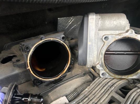

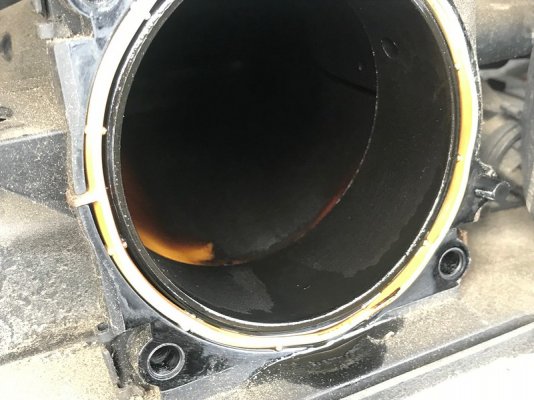

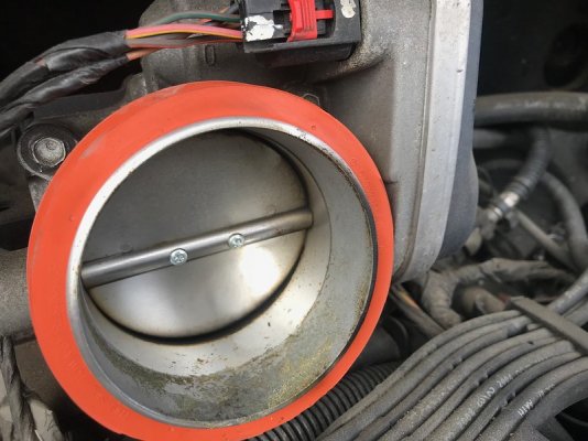

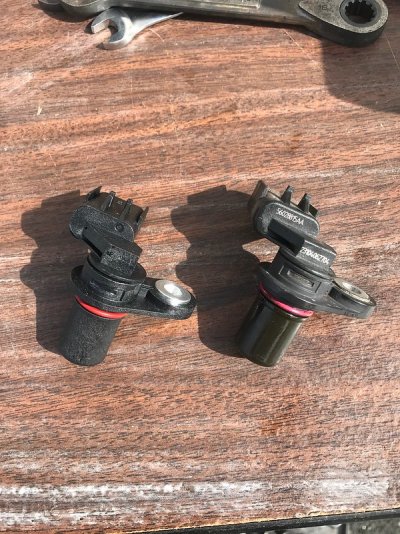

Just for an update. last weekend I did a bunch of work on the truck:
-bled the whole brake system and put in new fluid
-checked hubs and tie rods and ball joints up front for play

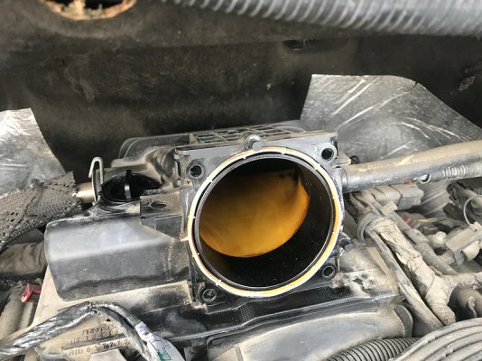

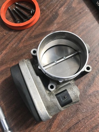

- removed and cleaned throttle body and upper area of intake

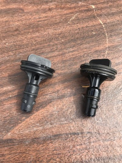

- replaced PCV valve with a MOPAR one
- removed and cleaned EGR valve
- replaced all 16 spark plugs with Champion copper 570 plugs
-replaced the Crankshaft Position sensor
- added Rislone to the oil system
- added 1/3 quart of Mopar automatic trans fluid
- new wiper blades
- aired up all 5 tires, spare tire inluded
- lowered and checked over the spare tire assembly
- checked rear diff fluid
- cleaned battery terminals

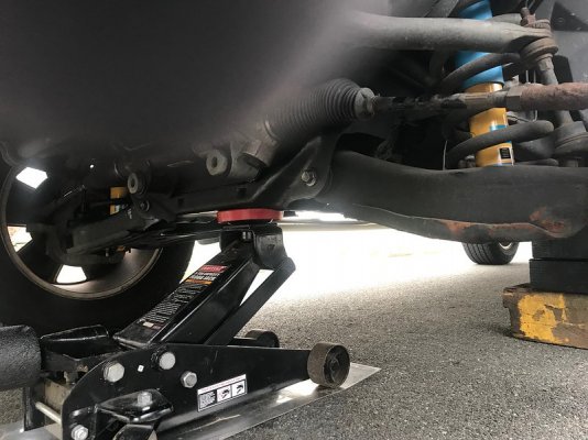

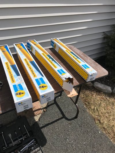

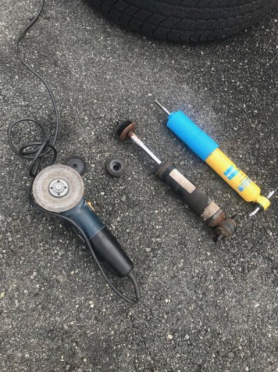

- installed the front two Bilstein shock absorbers (the rear will have to wait, the upper bolts were frozen on and i'll have to cut them off)
- washed truck
-inspected brakes and rotors (will put my New EBC pads and rotors on come summertime.
- checked all exterior lights and bulbs
- reset PCM (battery disconnected for 4 hours)
-checked belt tightness
-put a hose clamp where I think the slow power steering fluid leak might be coming from
- I did NOT seafoam the engine since I didn't want to possibly immediately foul out the brand new spark plugs. I might seafoam it another day though
So far, a few days of driving and I have not had a stalling out issue. fingers crossed; but I do get anxious each time I come to a stop in traffic.. I keep on waiting for it to happen....
