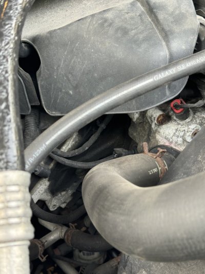

My engine has black oil on it.
KingMJ
May 20, 2024
Florida
I have a picture the best I could take . Runs and drives fine no issues . Noticed this morning . It’s a small spot about the size of a fist. Looking for some insight to what it may be. 2013 ram 1500 5.7 Hemi bighornIMG_2023.jpeg

Intake manifold gasket leaking maybe? I had the same oily spot. After reading @wildone post titled "check your manifold bolts" I cleaned entire area with simple green solution and re torqued bolts. 2,500 miles later no oil stain to speak of.

Thank you . Will try that and see if it solves the issue thank you!
