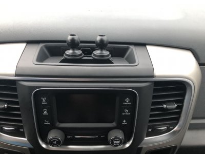

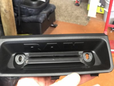

I was already invested in the Ram Mount system and wanted something that wasn’t intrusive when not in use. So I used the ram t slot rail in the upper cubby.
just mounted it with some screws( had to make one small hole in the radio bezel to clear the middle screw) if it loosens up over time I’ll use some small bolts.

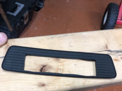

I also trimmed the rubber mat so it looks as factory as possible.

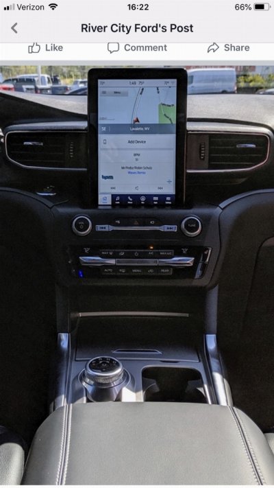

Try this on for size for blocking the view. This is stock in the new Explorer. Might as well have just stuck a mount in there themselves.

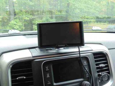

I love it. GREAT idea. I made one for my GPS but used the GPS mount to a plastic plate. I can remove the GPS but not the mount ! Love your set up. Thanks
