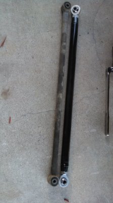

Here's my bar.

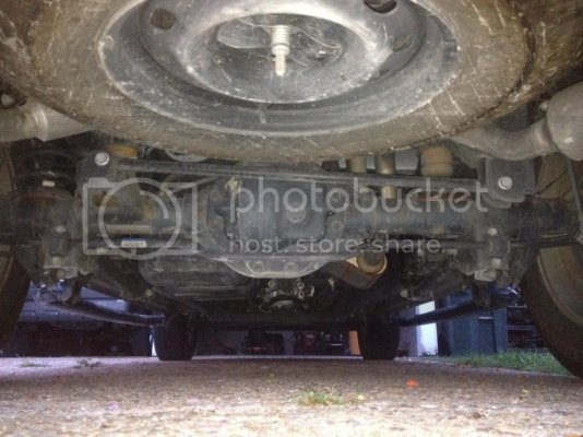

To do it the correct way you will need the panhard bar and the drop bracket with it.
Yiur bar should level with the axle.
This is my stock bar with a 2" drop
That is brutal, hoping my GF kit is level when I put it on, will purchase panhard bar if necessary.

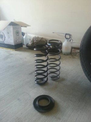

uploadfromtaptalk1410216010251.jpguploadfromtaptalk1410216024201.jpguploadfromtaptalk1410216073430.jpg
Done. Looks like it dropped like an inch so I guess ill have to let it settle. By the way this was sooo Damn easy compared to putting a 2inch shackle drop on a leaf spring. It only took me 2 hrs taking my time with regular tools. The only thing that was a pain was getting to that nut on the top part of the shock. Panhard bar barely moved.
