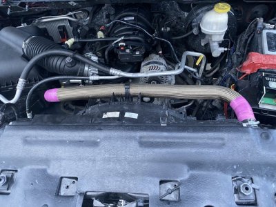

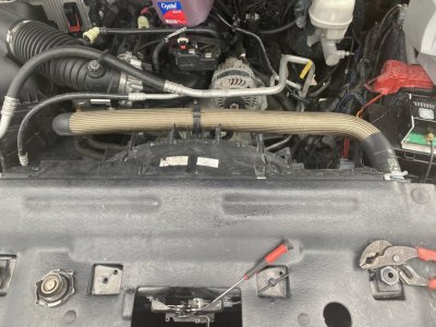

No more burning my arm if I’m working on the engine hot... dei sleeve heat shield over the upper radiator hose.
Little flare as well. Used purple tape over the ends to protect it from fraying and to keep it from sliding. It does use shrink wrap but wanted something nicer.

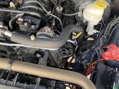

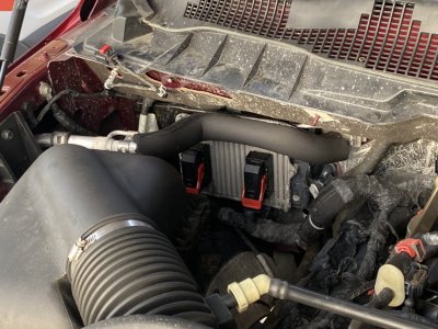

Insulated the ac vacuum Line. My ac has cut out a few times in this heat this summer. Temps are in Low to mid 90s with humidity in the 80-90% range. Real feel temps in the 100-108° range. When the ac is running you can touch the vacuum line and it’s warm. I installed closed cell foam insulation designed for ac units and water heaters. It’s fire retardant as well. Now my vacuum line is cool/cold all the way to the compressor and I have not had my ac shut off on me since I’ve installed the insulation. I think it was shutting off on high pressure from to much heat soak causing the compressor to work harder as well. Now the vacuum line being cool all the way to the compressor should also help the compressor to run more efficiently and hopefully last longer.

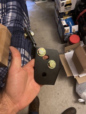

Thanks @ram1500rsm for the track bar drop bracket. I will be planning on reinstalling my rear spacers over my eibach springs when I install the bracket. It’s amusing how Carli suggests using this with their kit for the trucks but their kit only uses 1/2” lift springs and the drop bracket appears to be about 1-1/2” drop.
I know right ?. On top of that I've read their coil springs won't provide any lift at all even though Carli advertises 1/2" lift. I spoke with them and they said the spring rates are actually softer than stock so the springs will settle to stock height or a little more. Oh well.

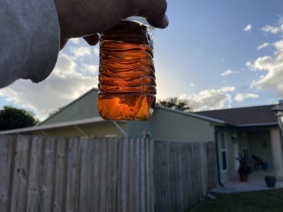

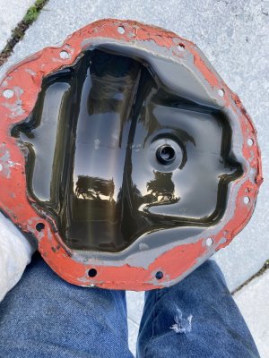

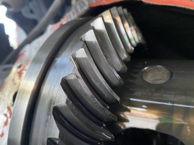

Just purchased a purple cranium rear diff guard and in the process of buying front and rear diff fluid as well as tcase fluid for my truck. 4 years and 33,000 miles on it. Changing the fluid as preventative maintenance and planing on cracking open the diff to check the gears and make sure everything looks healthy.

that rear will be much happier with some fresh Red Line in it. that fluid was looking pretty dirty.

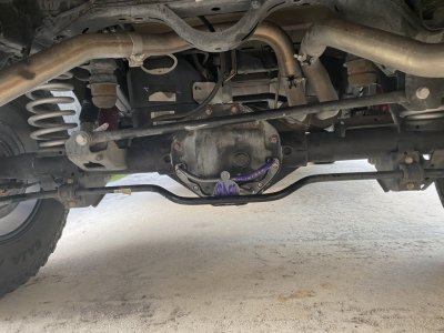

Wasn’t expecting this for a month as it said 4 weeks expected but it’s in and installed. Purple cranium half diff cover. Ordered in the basic hammered look. Looks great and fits great. Thing is beefy. However it is a super tight fit on the sway bar. Not even a 1/2” of clearance. This will be great for when I start doing overland camping in Georgia and Tennessee. Next when tax returns come through I’m buying Clayton overland plus rear control arms. All I have left to purchase after that is long tube headers and the aev snorkel kit. Then the truck itself will be done and I can start working on my overland setup.
