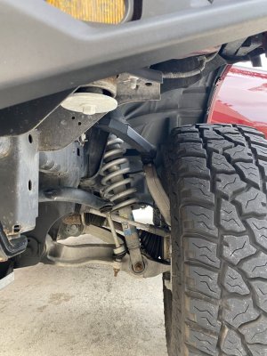

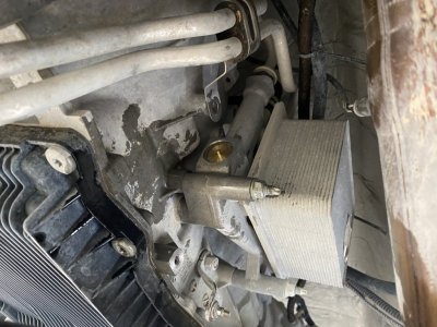

Pulled the thermostat out of the transmission heat exchanger today. Also took pictures of my truck at ride height vs max droop of the front suspension. Tires were still on the ground just lifted to the point where I could see the weight coming off of them. Angle at max droop is crazy

The transmission heater has been pulled. Have about 600 miles on my truck since removal. Have now added ppe pan to my list of things to buy.
If you’re up for a read this is a lot of info. https://www.ramforum.com/threads/revmax-8-speed-thermostat-bypass.171776/
my lsd seemed happier while off-roading since my fluid change as well. Drove 4 hours away and drove around for about 4 hours then drove home. 500 miles round trip.

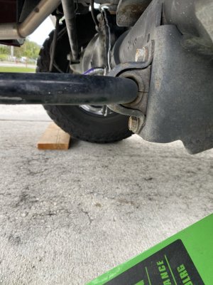

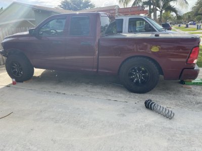

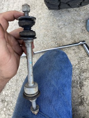

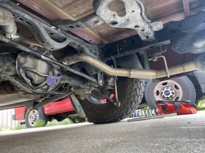

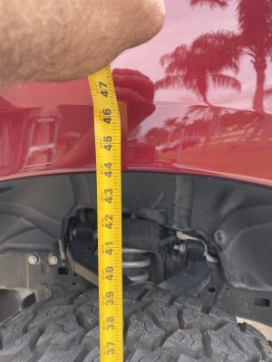

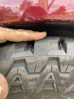

Took some measurements today. Talking to nick to order new 5160 rear shocks. Will probably be ordering the extended length shocks. Pulled my springs out to check tire tuck when sitting on bump stomps as well(picture 3). So my rear eibach springs measure 19-7/8. I installed my 1/2” lift spacers in the rear as well to accommodate the longer shocks. My rear springs will drop out at anything over 27.5” shock length. With the rear 1/2” spacer I get a pinch over 28” shock length before they will drop out. I’m binding the rear control arms at that point because the tires actually lift off the ground. I will need to add a 1/4” spacer on the rear sway bar to clear the rear diff guard. It just barely touches. Can’t wait to buy some bilstein 6112s for the fronts. Will be setting them to 2.5 with my 1/2” top hat spacer and will probably get a little less since I have full skid guards and an off-road bumper. Hoping for between 2.75 and 3” front lift.
Measurement from ground to top of wheel well with springs removed is 35.5”. (Picture 1)
Measurement from ground to top of wheel well with the stock replacement bilstein 5100 fully extended is 45.5”
Measurement from ground to top of wheel well if shock length is at 27.5” is 47”. That is the length of the 5160 fully extended. Picture 4
Measurement of current rear ride height ground to top of wheel well is 42.25”

I'm running 28" shocks and with my squished bilstein rear coils and a 1" spacer my coils come loose enough to rotate but don't unseat enough I can take them out. So you should be money with the 27.5" length.

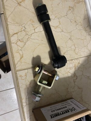

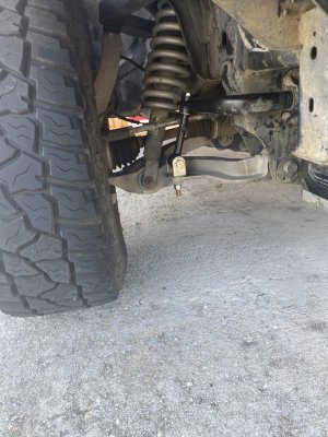

Received some kryptonite sway bar links. Ordered the gm ones. I need to modify the bolt in the u bracket. It’s a 1/2” bolt. I’ll have to figure out the size of ours and just tack weld a new bolt in. Should not be a problem. I may email them and see if they will make a ram specific set. Possibly in an 8” length for leveled trucks.

Yes. I’m going to use a push pin through the u bracket instead of a bolt to go through the lower bushing. It’s 7.5” from mount to mount. I’m hoping they email me back on a ram specific version that is 8” in length. It would be perfect for our trucks in my opinion. The upper bushing that goes to the sway bar looks just like the ones for your suspensionMaxx links. I think they are poly. Or I’ll drill a hole through the bolt and use a latching pin in the hole to lock the bolt from falling out

Swapped the bolt out to a 1/2”. Stock was 12mm. Tried to find a 7/16” bolt but no luck. Unfortunately I won’t be able to use this as a quick disconnect but I’ll deal with having to unbolt it. The stock ones were beat and they only had 10,000 miles on them... granted they were being beat on and definitely wish they were a bit longer. This setup seems a bit beefier. I need to get this paid off so I can just buy an old Jeep to beat on and use this as the tow rig
