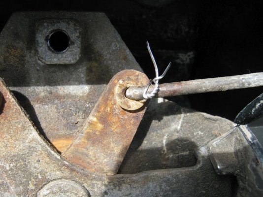

So if I pull the handle, it works fine except the right side which hangs up so you have to pull up on that little lever to get it to open on that side. How does the tailgate mech work? Anyone have a drawing of it? That way I can either figiure out how to fix mine or start looking for a good clean used one. Just went out and looked again. The right side bar that goes form trhe handle to the right mech is not hooked to the handle anymore. How does one fix that?

all that broke is the plastic clip. you can usually find them in the Help section at the auto parts store.

Cool, thanks I'll go get a couple.
