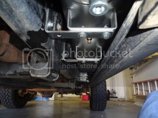

I'm about 95% done. The tank has been mounted the same way as the compressors, L bracket and drilled and tapped frame. Once I get the final plumbing done, I'm going to put some sort of splash guard under the compressors. I should have the last few parts in by Monday then I'll just have to apply thread sealant to all the fittings and connect the compressor air lines to the tank.

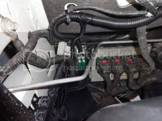

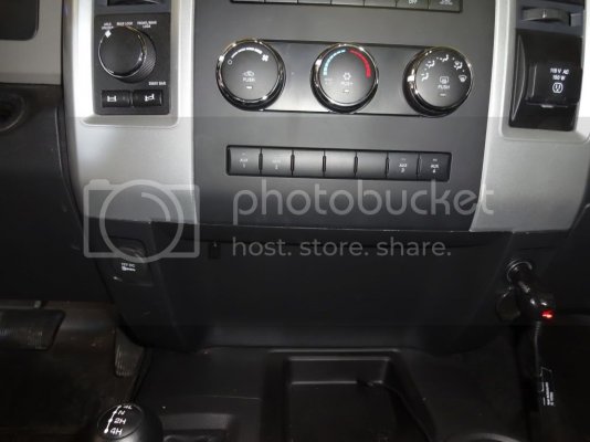

I mounted a toggle switch on the bottom side of the dash. You can't even tell it's there when you're sitting in the truck but it's easy to get to. It's wired to the 12V outlet that's ignition switched. This wire goes under the hood to the positive side of the relay coils. Then the negative side of the coil wires goes through the pressure switch mounted on the tank.

S2kiHemi
Jan 15, 2012
3,505
140
Houston TX
09
The compressors and air tank should be pretty protected where you mounted them. Clean install.
They are protected pretty well from big stuff hitting them off road but they still might get caked in mud. A thin sheet of metal over the bottom of the L brackets would be pretty easy to install and couldn't hurt anything...
Very clean install. I bet you are glad you have such a long truck. That's alot of hardware under there.
It's a very tight fit. The floor storage that hangs down made things a little more difficult. I really wanted a 5 gallon tank but all the ones I found were about an inch too long.

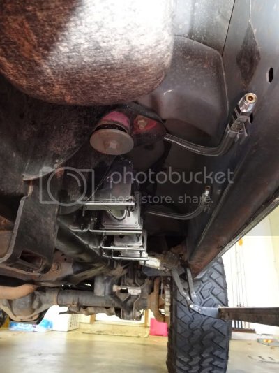

I'm 100% done with the system. I got my airline, fittings, and Loctite 545 in the mail on Monday and finished up the final plumbing. I flipped the switch on to start the compressors and nothing happened. I started checking fuses, all were good. Then checked the relays, both were functioning correctly. Checked voltage at the distribution block, relays, and compressors, everything was showing 0V. When I turned the switch off then I had 12V at the distribution block and one side of the relay, just as I should. Turned the switch back on, and 0V everywhere. Check fuses again, two on the distribution block and one at the battery, all ohmed out good. I was frustrated and tired so I called it a day. I went to school for electrical engineering, I shouldn't be having these problems.
Went back out yesterday with a clear head and it was obvious what was wrong. With the switch off, I had 12V right after the fuse at the battery, but with it on, it went to 0V. I replaced the 60A glass fuse and the compressors fired up. Not sure why I didn't try this the day before. I've never seen a fuse that would ohm out good but be open when a load was applied. Very odd...

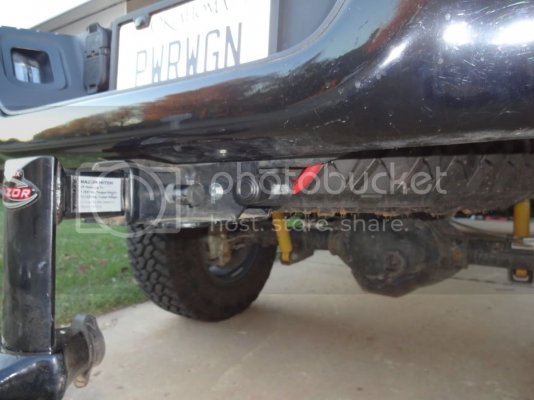

I then decided that I didn't like the location of my quick connect, so I got some 1/4" air hose and routed it to the rear of the truck. It's mounted to a strip of aluminum and covered in plasti-dip. I covered the quick connect with a rubber table end I got from the hardware store. I used hose barbs and hose clamps for this connection, I hope it doesn't leak over time. If it does, I'll replace it with some DOT airline and compression fittings. So far, I don't see any leaks. I'll let it sit for a few days then see if I've lost any pressure. Fill time from 0 psi to 145 psi was just under 3 minutes. I've got my tire inflation gun and about 20' of air hose that I will keep in the truck. This will reach all of the truck tires as well as the tires on most trailers.

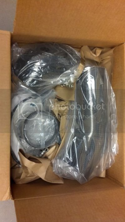

Thanks Matt! The big brown truck just dropped this off as well. :D
