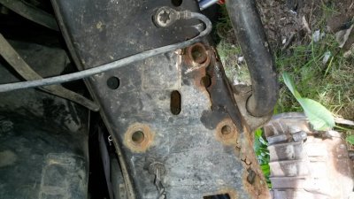

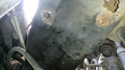

here is a pic of what im dealing with
The first pic is the outside the second pic is the inside. Thanks

likely junk. If that spot is that bad, you need to ask what you can't see, as well as other places on the frame. That's probably the worst place to have that happen too. Gonna be a serious amount of work to fix correctly. Take a good look at the rest of your frame, and see if it's worth repairing that section, swapping frames, or putting your good parts into a different truck.

That is the only spot on the frame with any rust

If so, then it's probably worth repairing that section. Thought about splicing in a donor section rather than bandaging that one?

Yes I have a donor section but not sure as to how far back I need to take it back because of the wheel components and all of that my donor section was cut right under the cab

Yeah, that's gonna be the $64,000 question,... hopefully not literally
The hardest part will be keeping it straight (or at least the same straightness as the existing portion). Gonna be major surgery.
