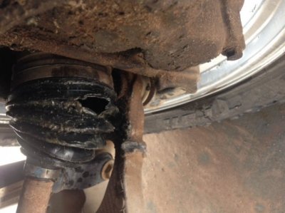

Definitely was not fun - pics of the progress. The whole little spindle yanked out without the UCA off of it, but like you mentioned, it did need to come off to install the new one.
We took the caliper and rotor off to start with just to have more room. Shattered a 13/16th socket with the impact wrench doing so and ended up doing it with a box ended wrench (because apparently I don't have another deep 13/16ths? I swear I did)
I'd definitely suggest pulling the UCA off from the beginning, as even getting it out in pieces was difficult.
We unbolted the UCA and it didn't come off either, like you'd think it would with the weight of the hub? Used a floor jack and a long block of wood to press it up and it finally all came apart rather violently. My bf and I both jumped back when it did slide off.
Crappy part is not having a lift, and getting a good placement on a jack stand where it isn't in your way but is still safe...do able, but...yeah, makes me nervous. Now I just hope and pray I don't have to do the driver side!
