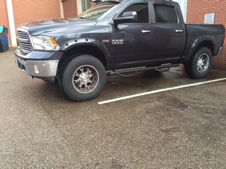

SOOOOO I have about 30 miles my 37's w/ 3.21 gears. I retuned the truck right after I got the tires on. obviously there is a lose of power but it still has it. The 37's i put on are actually some how 5lbs lighter per a tire. Don't ask how I am just going by the manufacture weight. Feels good and I like them so far. The real test will be next friday when I have a 500 mile drive then the following week back home. Will update.
For whatever reason those ATII's are heavy, even the 33s are 74 lbs ... I'm curious as to why myself

I have no clue but those pro comp AT sports are actually cheaper than those toyos and have a far better warranty. How a 37 is cheaper, lighter and better warranty.

So I now have about 4k on these tires in less then a month. I might drive to much. My first 1k trip with these I wasn't happy about my MPG. I got it's a truck with 3.21 gears and 37's. I am just letting other know that are interested in this tire/gear setup. Yesterday, I drove 300 miles back home and actually got 19.3 MPG. The terrain was pretty flat most of the way home with some hills a long the way. Anyways Love the tires I do wish I had a different gear setup.
