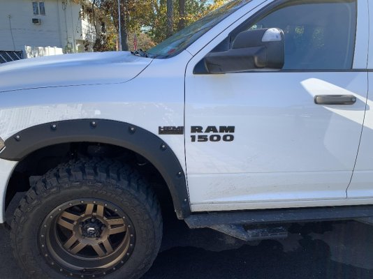

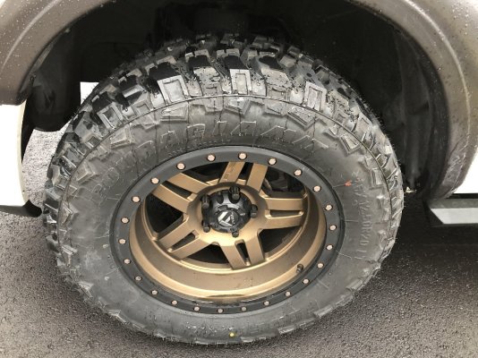

If you have an express with express rims I don’t believe they are 9”. The sport rims are 9”. Do you have the sport rims? The express rims are 8 or 8.5” IIRC. Some places (especially around me) will not mount a 35x12.5 on a 8/8.5” rim. My brother had Ridge Grapplers installed on his 2015 Sport (stock sport rims) but opted for the 35x11.5x20 tires to avoid possible rubbing.
That said I have a 2014 express w/ 35x12.5x20 Federal Couragia’s mounted on 20x10 -18 offset Fuel rims. Lift is Bils at 2.8, Bils in the rear, Airlift 5000 bags and a Zone 1.5” BL. Very slight rubbing on front fender liners which was easily fixed with a utility knife. No rub at all in full lock now. BTW I did add Zone UCA’s.
I would avoid the wheel spacers and by the correct rim with specs for the tire you really want. The Federals IMO are excellent for a mud tire (I’ve ran a lot of Brands) and don’t cost $380-475 per tire! I got 4 from Walmart shipped to the house and installed for under $1k.
